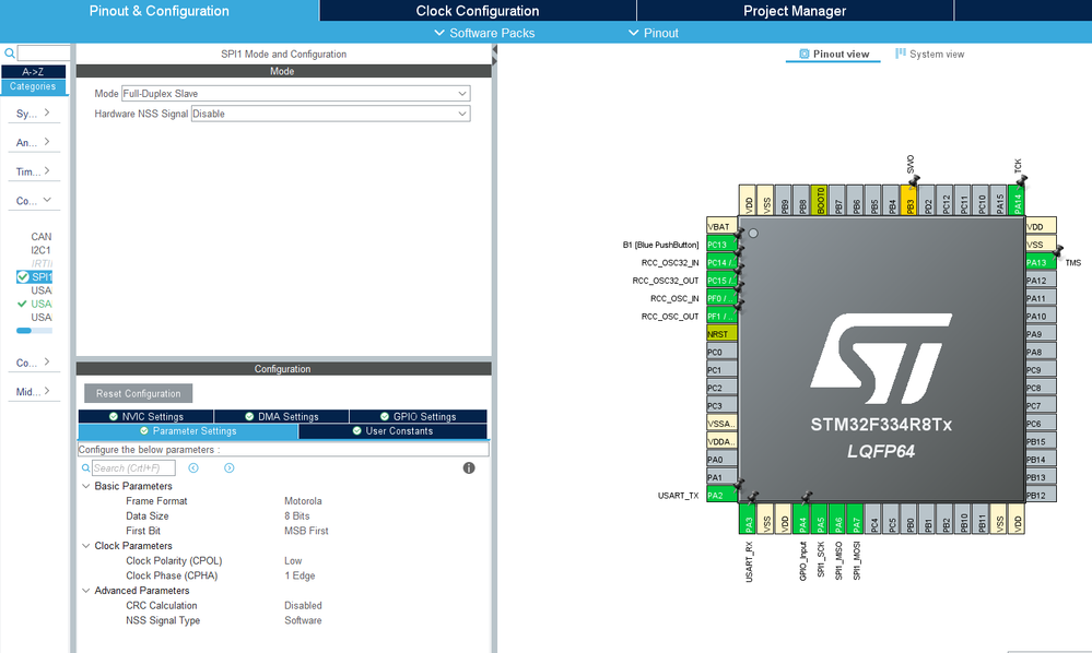

I'm trying to build a setup to test SPI communication between a master and a slave.
The master side works well, when the master ask for a read, it sends a byte of register address and ask for 2 byte of reading (I can see 16 clock ticks for the reading).
Unfortunately my slave code doesn't work as intended, it's receiving correctly the register address but when it comes to the transmission it always fails, nothing is getting outputted on the MISO line.
Here's the code for the SLAVE spi part:

And the configuration of the slave SPI:

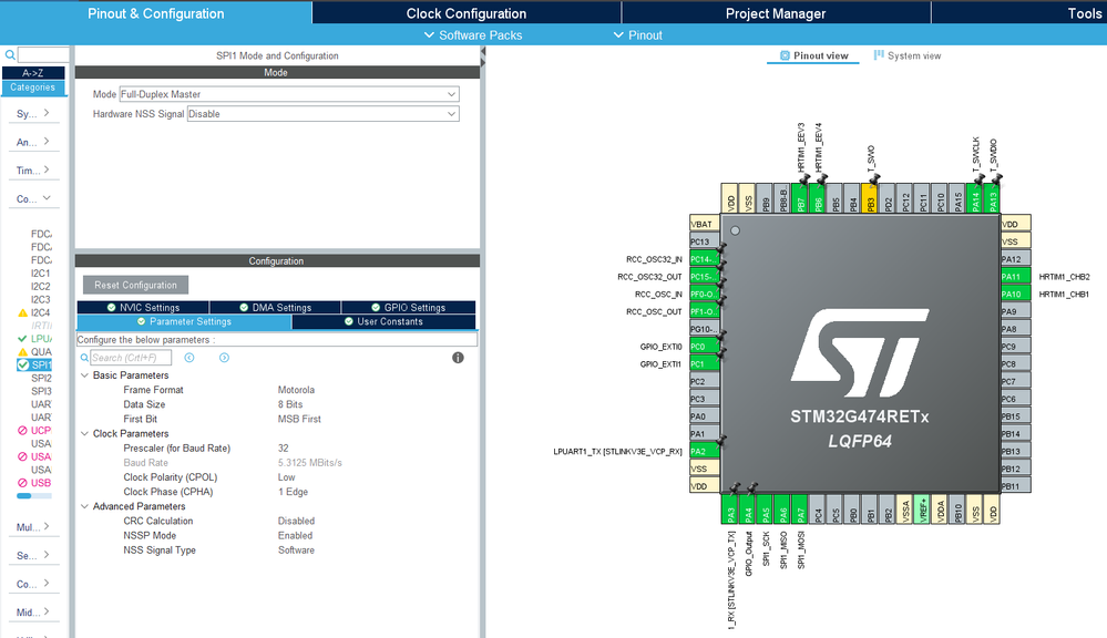

The master side is of course configure the same way:
I think this is a programming issue but I don't get which one.

‎2023-09-22 3:13 AM - edited ‎2023-09-22 3:28 AM
This might not help but are you sure you want Full Duplex mode? Can you try with Half Duplex and see if that allows you to transmit after you have received?
Also, you might want to look at HAL_SPI_TransmitReceive() and read this thread then compare against what you are actually trying to achieve:

‎2023-09-22 4:31 AM
Perhaps the master code is not waiting long enough between events (CS down, sending first byte) to let the slave sync. Master and slave need to be in sync with each other. Show the master code.
