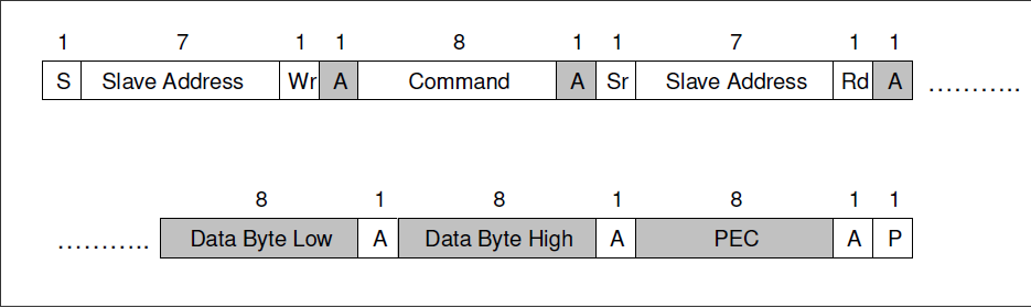

The S stands for start and the Sr for restart.
How do I generate the repeated start condition without stopping and also send ack and check for ack?
I have been using theHAL_I2C_Master_Transmit andHAL_I2C_Master_Receive functions.

I am working with a sensor which communicates using i2c. I am very new to stm 32 and could only figure out the basics of the code.I have successfully obtained data from other sensors using i2c. This particular sensor has the following protocol to obtain data.__GPIOB_CLK_ENABLE();

HAL_I2C_Master_Transmit(&I2cHandle, (uint16_t)0xB4, (uint8_t*)read1, 1, 10000);
HAL_I2C_Master_Receive(&I2cHandle, (uint16_t)0xB5, (uint8_t *)Buffer1, 3, 10000);
HAL_I2C_Master_Transmit(&I2cHandle, (uint16_t)0x00, (uint8_t*)read2, 3, 10000);
HAL_I2C_Master_Receive(&I2cHandle, (uint16_t)0x01, (uint8_t *)Buffer2, 2, 10000);
where read1 has the address of the register and 0xB4 is address for read ,while 0xB5 is for write.

Try using the so called Memory read varaint (HAL_I2C_Mem_Read)

yes,use function HAL_I2C_Mem_Read
