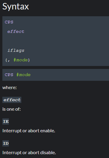

Question number 2: while reading programming manual PM0253, I ran into CMSIS functions that generate processor instructions (page 62). The first ones are CPSIE/CPSID. I searched for what they are and ended up on ARM website, which describes what it does and what its parameters are, but gives no context. So I know how to use instruction, but I actually don't know what it does and why would I need it (especially if my program is in C and I can enable or disable interrupts by writing directly to NVIC-related registers, which is can do easily).
So, here is a piece from the ARM website:
0693W00000QNzzjQAD.pngMy problem with it is the word "abort". Aborting what? I mean, there are 100-ish interrupts on the MCU I'm using, that's clear. But what is Abort? Abort what?

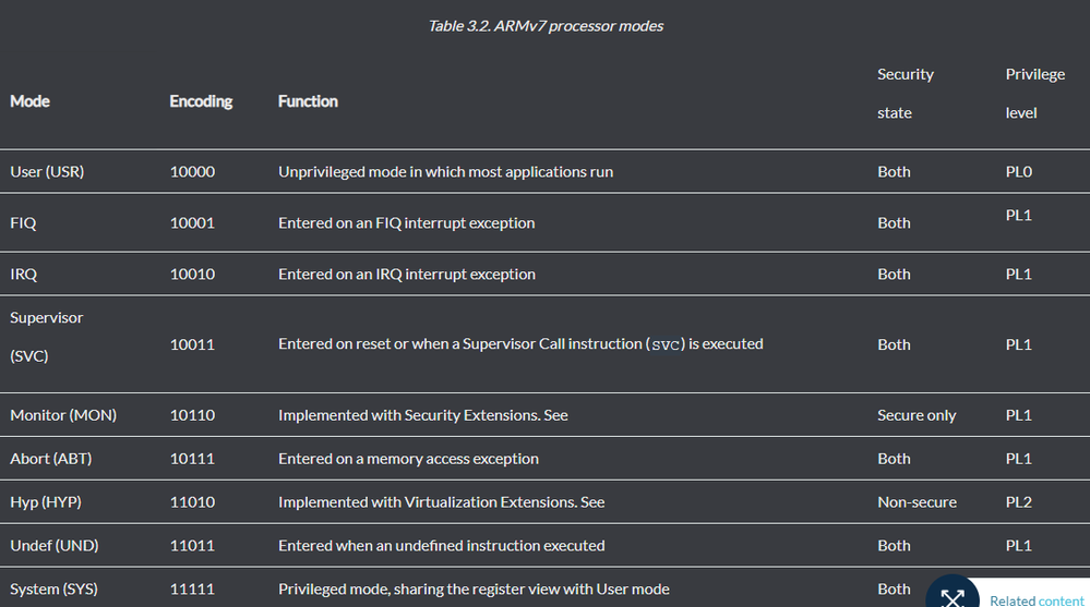

Next, it also mentions some "mode" of processor, so I searched that and ended up on ARM page describing these "modes" that I've never heard of. Not thread and handler mode, but some other modes, which have some weird numbers. Here:
As far as I can gather from it, USR mode, which has priviledge level PL0, is basically a thread mode, while PL1 seems like handler mode to me (let's not talk about PL2 for now). Also, as far as I can guess, FIQ means fault handler. Also, my intuitive guess is that different exceptions are associated with different modes (abort mode for memory access exception?). I take it, when I write code in C, the compiler does this mode switching? Or does it happen automatically when exception handler is triggered? What is the point of CPS change processor state instruction? What's the point in manually setting mode to FIQ? And what will happen if I call fault handler while having IRQ mode? They have the same priviledge after all. Oh yes, and I still have no idea what that ABT abort mode is and what it does, it looks like a separate mode that handles memory access exceptions, like MPU-related exceptions. In fact, I failed to find any mention of any of these modes (their abbreviations) in Datasheet/Reference Manual/Programming Manual of my MCU.

The IRQ can be masked via the CPSID / CPSIE, it gates the NVIC's control

No, heaven forbid. It's very concrete, NVIC is a Cortex-M thing. Cortex-A has GIC.
ST's Programming Manuals explain the NVIC (these manuals are based on some old good version of the ARM user documents). There also is the classic book by Joseph Yiu.
Keil is ARM; what says Keil - says ARM.
By the way if you've already discovered CMSIS documentation, please read on the __disable_irq , __enable_irq, __get_BASEPRI and related macros. This precisely explains the intent and use of CPS in Cortex-M.
