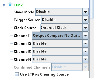

I am trying to implement a milli and microsecond delay, most importantly a micro delay as milli is obviously provided by the HAL libraries. My knowledge of timers is quite limited so I might be missing some key concept here.
I have been having some success with getting a milli second timer going but a couple of things that seem to work have left me with some questions. I added a timer to my project through CubeMX.
My through process was to be able to change the clock prescalar to switch between micro and milli and then simply do a count compare in a while loop to perform the delay.
My default generated timer config code is as follows

The micro second delay seems to work well but the micro does not work as expected. I also was getting weird results until I added the PCLK2_FREQ bit, but I was unable to get it from the system so I used a define. Any tips on how to get that from the system would be appreciated.
By my reasoning the milli second delay should work with my 180Mhz sysclock if I set a prescalar of 180000 but it does weird things.
Any help would be very much appreciated.
