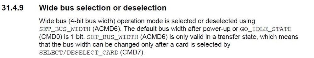

Hello;
I want to use 4Bit SDIO on STM32F407VGT6 MCU. I already set all parameters on lastest STM32CubeMx software.
RCC => External Xtall
SDIO =>4bit bus
My Ide is KEIL 4.73.
But this configuration is not working. When i use SDIO 1bit mode , it is works!
I already tested my board and connections(pull-ups,caps...) with ''https://github.com/MaJerle/stm32f429/tree/master/21-STM32F429_FATFS''
4Bit SDIO Example. So my board is working 4bit SDIO mode with this example. I checked with oscilloscope.
How can i run 4bit SDIO FATFS with STM32cubemx on STM32F4?
Bests,Thanks.

The 4-bit SD Data Transfer Mode is Mandatory for High-Speed Cards, Optional for Low-Speed ones, so it depends on the used uSD card type. Otherwise, it's better to configure first the 1-bit SD Data Transfer Mode:
hsd.Init.BusWide = SDIO_BUS_WIDE_1B;
And then, just enable wide operation, for the 4-bit SD Data Transfer Mode:
HAL_SD_WideBusOperation_Config(&hsd, SDIO_BUS_WIDE_4B);
Here below some screen captures from the RM0090 reference manual: 0690X00000602zAQAQ.jpg 0690X00000602zFQAQ.jpg PS: You can refer to the stm324x9i_eval_sd.c/stm324xg_eval_sd.c BSP drivers, that may help you! Regards, Heisenberg.
