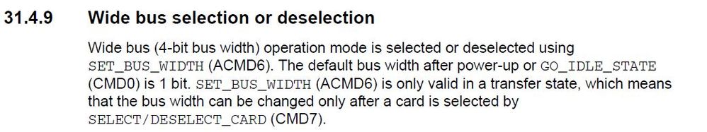

Posted on December 11, 2014 at 15:04
Here below some screen captures from the RM0090 reference manual:
Regards,
Heisenberg.
