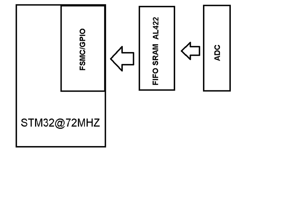

if i have stm32 at 72mhz
what is the maximum adc chip speed i will use with stm32 at 72mhz ? #drinking-from-a-firehose- Mark as New
‎2016-01-15 11:17 AM
The SPI and FSMC interfaces would tend to put an upper limit on it, and what you expect to be able to do with the data.
‎2016-01-24 6:55 AM
thank you i just want to maje low cost oscilloscope
and i want to get the maximum sample rate with stm32 what is the best connection interface type between adc and stm32?- Mark as New
‎2016-01-24 8:11 AM
Well IRQ's are going to top out at a few hundred KHz
FSMC Might deliver 9-12 MSps, but you have a very small capture buffer.The DCMI on the F4 might offer 54 MSps.You might be able to get significantly higher rates with CCD/FIFO arrangement to handle the disparity between the high sample rate, and lower/smaller processing rates.Up vote any posts that you find helpful, it shows what's working..

thank you for helping me . so this is the best connection
‎2016-01-24 10:10 AM
There are certainly chips in that domain that can get you to speeds and capacities beyond the performance of the STM32 itself
http://www.glyn.com/data/glyn/media/doc/AVERLOGIC_product_overview_07092010.pdf
You'd have to determine the goals for speed, width, depth and cost.Up vote any posts that you find helpful, it shows what's working..

the goals for speed
is take afew sample to draw it in lcdwidth
i will use 2 adc 8bit
''16bit''
inInterleaving ADC
mode to increase speed timedepth
if you mean the sample recording length 1kbyte is enough
but the problem know clock source ? how to get HW clock out from stm32 and it must change apple- Mark as New
‎2016-01-29 9:00 AM
Had me thinking for a second, changeable...
