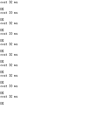

Here is the test results:
1. Radio.Sleep with  STOP2 mode,each transmission test costs 36 ms.
radio sleep with STOP2radio sleep with STOP2

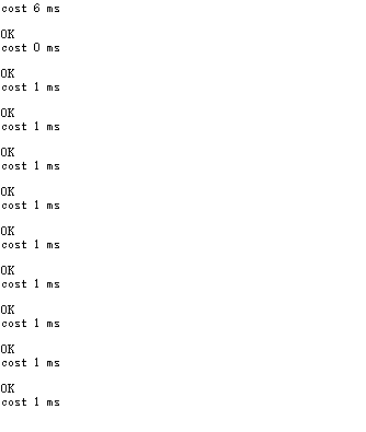

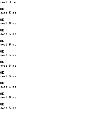

3. Radio.Standby with  STOP2 mode,the first transmission test cost 35 ms, after that, each transmission test costs 5-6 ms.
radio standby with STOP2radio standby with STOP2
4. Radio.Standby with  SLEEP mode,the first transmission test cost 6 ms, after that, each transmission test costs 1 ms.
radio standby with SLEEPradio standby with SLEEP
