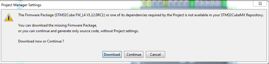

when I try to open the example with cube to generate code this message appear
But download doesn't work because the current version 12 is not RC1.
regards

I think a  workaround is to delete the rc1 in the ioc file with any editor.
But then CubeMX doesn't include the Hal Librarys and cmsis (folders are empty).
after adding files by hand true studio give me the message, because the whole build settings are missing..

Imen.D
Posted on June 11, 2018 at 11:15
Can you please share your ioc file for check your issue.

Posted on June 13, 2018 at 03:26
it's in every ioc from the new package BlueNRG-MS
BlueNRG-MS\1.0.0\Projects\STM32L476RG-Nucleo\Applications\
I guess these examples should work or are they just templates for cubemx ?
regards

Nawres GHARBI
Posted on June 25, 2018 at 18:43
Hi 0x90
Will be fixed next release thanks for reporting this issue
