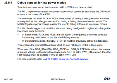

See section 33.9.1 in the Reference Manual:

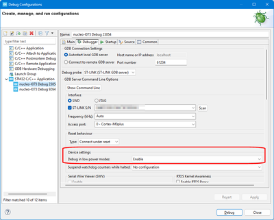

Also, if you're using STM32CubeIDE, enable debug in low-power:

The features mentioned in section 33.9.1 of the Reference Manual are internal to the chip - so shouldn't be restricted by what debug probe you use ...
You'd have to ask Keil what is their equivalent of the  STM32CubeIDE's "enable debug in low-power" feature:
