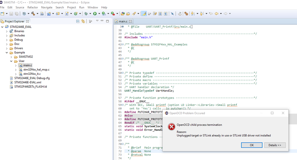

I cannot dbg and programming stm32446e-eval board using onboard st-link, pic below. I checked also other board stm32f769i-disco and its working fine on the same enviroment.
Log:
Unplugged target or STLink already in use or STLink USB driver not installed

Error: open failed (no matching adapter found)
in procedure 'init'
in procedure 'ocd_bouncer'
How to fix it ?

Make sure it works with the ST-LINK Utilities, and check the firmware version is current.
OpenOCD may be checking for a chip ID it doesn't support, in which case you should get a current build that does.

I updated firmware to the newest version and still the same
Strange but using TrueStudio I can dbg and prog this board.

Hi I found bug on my PC motherboard. When I use USB 3.1 its not working, when USB 2.0 interface everything is ok. EVB is supply both cases on ext PSU.
I have ASUS RAMPAGE V EXTREME.
Thank you for suggestions.
