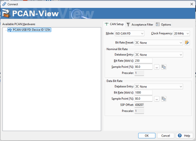

Hi!
Has anyone gotten this to work for the STM32H723G with FDCAN bootloader and is willing to share the PCAN-View setup that was used?
Thanks in advance!
The Baudrate is 250Kbit/1Mbit. You can use the setup used by Bergen:
https://community.st.com/t5/stm32-mcus-products/st-rom-bootloader-fdcan-canbus/m-p/712765/highlight/true#M258893
Martin
embedded_bot
Thank you, I saw it but didn't interpret it right.
This is the setup that worked for me, on the three dots next to sample point (%) input make sure to choose the tseg1 and tseg2 according to Bergen message linked above.
