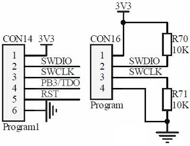

My daily use IDE is Atollic, my board used to have a single 6 pin connector for programming, and everythin worked fine since I can remember.
The new hardware guy decided to add another connector to program the MCU (STM32F4), and our new board ended up like this:
He also insisted that we should use the 4 pin connector, and promptly made new cables for everybody in the team. Despite being identical and respnding normally to the meter continuity test, some of the cables worked and others didn't.

What is the difference between using the 4 pins interface and the 6 pins ?

The real external ST-LINK pods have a buffer powered by VTarget, if your pods are blowing up, check that your supply isn't spiking. Certainly indicative of a more systemic problem with your board, and not just the connector.
The NRST pin provides for a means of holding the chip in reset will trying to connect, this can help when you have your own code on the chips that break the debug interface by reconfiguring the pins or going into low power or sleep modes.
