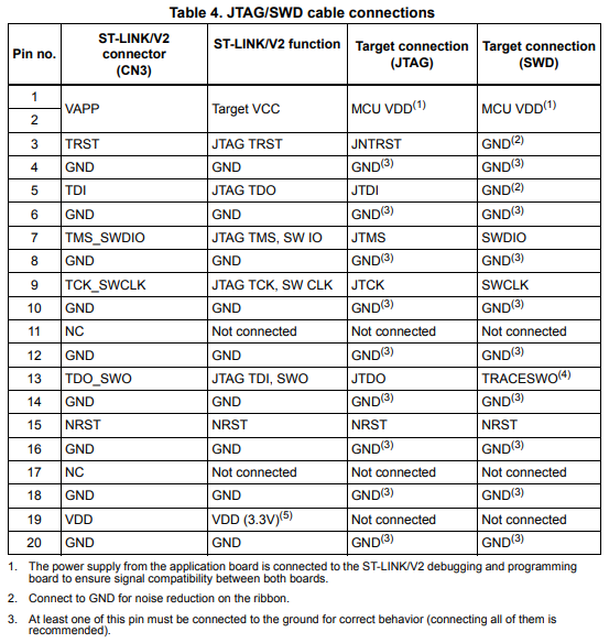

Hello
I want to use the
ST-LINK
/V2 to program a custom
STM32F0
micro
troght
SWD
Taking a look at
ST-LINK
/V2 User Manual
UM1075
I had a doubt about
VAPP
pins
These
pins
1
and
2
), are input or output
pins
I guess these
pins
are inputs and should be connected to my
power
supply
board, enabling the
STLink
to do identify the
power
supply

The note (1) seems to tell that the ST Link has a level shifter for the digital signals (3.3V, 2.5V, 1.8V), this level shifter needs to be powered by the application. Its consumption should be small.
I guess the STLink also uses VAPP as analog monitoring to detect when the application is unpowered and return error message when trying to debug.
The rest of ST Link electronics is powered by USB.
Typically, debug required minimum 4 wires.
