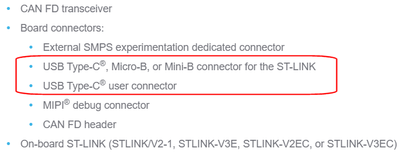

nucleog0b1re.jpgI see only one connector Type micro-B, which is also labeled as "USB_STLINK". So I guessed it was used for both and that it cannot handle communication for st-link and USB at the same time... am I wrong?
@GioBytem wrote:
I see only one connector Type micro-B, which is also labeled as "USB_STLINK". ?
 I don't have one of these boards to check, so only working from what's on the Product Page:
https://www.st.com/en/evaluation-tools/nucleo-g0b1re.html
I did notice that the picture there only shows one USB, yet the description does mention two, as shown previously.
The User Manual makes no mention of any user USB connection.
The Schematics show no USB connection to the Target microcontroller.
So it looks like an error on the Product Page - @STTwo-32 ?
There's no Hub on the board, so it can't do both.
It will be just the ST-Link connection.
