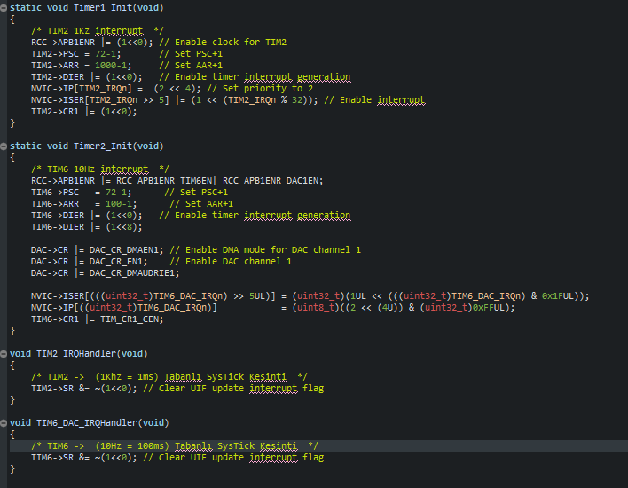

ST community Hello, my question is I want to use two generic interrupts on STM32F302R8T6 but one of them is not working. TIM6->DIER |= (1<<0); TIM2_IRQHandler works when I comment out this part. How to use global truncation for both?

I suspect the problem here:
NVIC->ISER =
NVIC->IP[...] =
This definitely doesn't do what you think. IP registers are accessed as 32 bits, and a single register contains 4 priorities for 4 interrupts.
Use NVIC_EnableIRQ() and NVIC_SetPriority() instead of your home-made code.
My STM32 stuff on github - compact USB device stack and more: https://github.com/gbm-ii/gbmUSBdevice
Don't use the TIMx->SR &= forms, use TIMx->SR = mask, it clears the interrupt and is safe
If the interrupt doesn't clear properly it will reenter/saturate, but that doesn't look to be the issue here.
