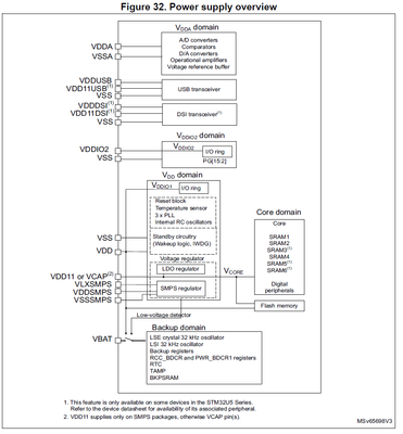

The SRAM2 is contained in the Core domain,  in should not affected by the reset of the Backup domain which contains : the LSE, LSI, Backup registers, RCC_BDCR and PWR_BDCR1 registers, RTC, TAM and Backup RAM.

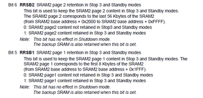

Thank for the description, I just want to check something. By default in Standby mode the contain of all SRAMs are lost unless you activate the RAM retention with the RRSB2 and RRSB1 bits in the PWR_CR1 register (the default value is 0x0000 0000) with the function HAL_PWREx_EnableSRAM2ContentStandbyRetention.

that is not the case in the specific situation. The standby (with SRAM2 loss) is in that step of our process not used to recover the LSE/LSI. I have some code that forces the backup domain reset and already stepping through that code with the debugger I can see the SRAM2 been erase. SRAM1 and SRAM3 keep their content in that situation. After that I force a software reset. (No low power standby sleep there.) The standby is used within the rest of the application if the configuration of the LSE/LSI is over.

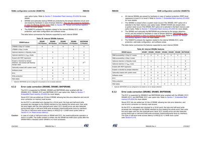

waclawek.jan
It's unsettling to find out that ST does not document all changes in silicon between revisions in the ES.
[EDIT]
This change has been specifically made in the RM:
And this is even more unsettling: the RM now deliberately incorrectly describes the behaviour of the Rev.X silicon.
Btw. the most recent Erratum which does not mention this change is dated March 2023, whereas the RM which does reflect it is dated February 2023...
