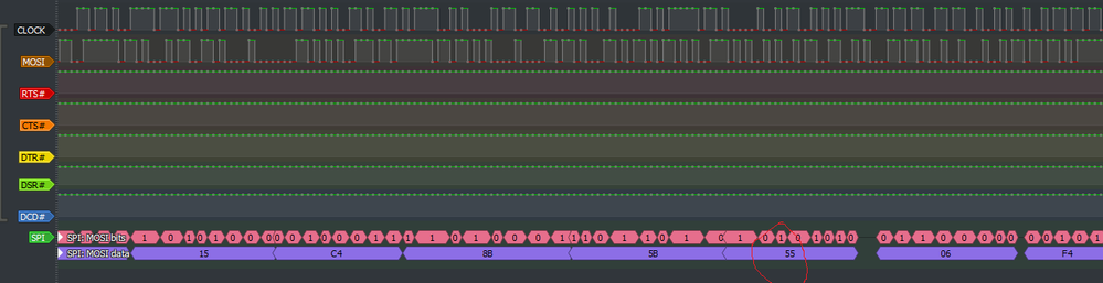

Hi everyone,
So, i would like to test SPI1 communication on my stm32F103, using just the clock and MOSI line by sending 0x55 data on MOSI line ,
but when i see the traces on logic analyzer, i'm getting a weird values !
as seen in this capture picture, furthemore the clock signal is not symetric,
This is my code , if anyone has suggestion
Thank you .
