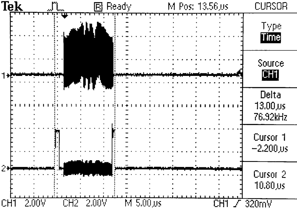

Hi all,
I'm triyng to make the fastest possible driver to comunicate with an ILI9341.
My question is about DMA.
If I send a burst of bytes to the ILI9341, lets say 1000, is the DMA version faster than normal version?
I mean if
         HAL_SPI_Transmit(HSPI_INSTANCE, BurstBuffer, 1000, 100);
Is different in speed of execution than
        HAL_SPI_TransmitDMA(HSPI_INSTANCE, BurstBuffer, 1000);

L4R5 120 MHZ: Trace 1 SPI clock (30 MHz), trace 2 Task work: Polling0693W000000X1UNQA0.png

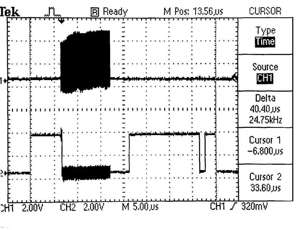

L4R5 120 MHZ: Trace 1 SPI clock, trace 2 Task work: DMA
Before the SPI data: DMA start (DMA was configured before)
After the SPI data: DMA Interrupt handler, task signaling, task switch, and at the end DMA clear.
In this case polling: 13µs, DMA 40%µs
The SPI frequency is fast, the message is short: not suitable for DMA!
And remember: in general, the HAL functions are not fast. It might be better to write your own polling write routine: it's not complicated once HAL has configured the SPI ...
