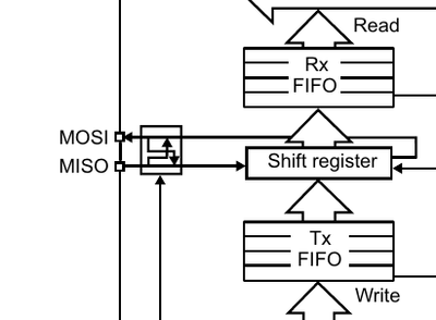

I use SPI1 module in FullDuplexMaster Mode.
I use interrupt to receive data from the SPI Slave.
The Thing is that if I add the Line which is arrowed--->HAL_SPI_Receive_IT(), the sending is not happening.
I want to know why this is happening. help me why?

‎2024-03-17 5:03 AM - edited ‎2024-03-17 5:06 AM
Try with (only using) :
HAL_SPI_TransmitReceive(..);
on full duplex spi, always both happen together, transmit and receive, see rm :
‎2024-03-17 6:49 AM
Use HAL_SPI_TransmitReceive().
