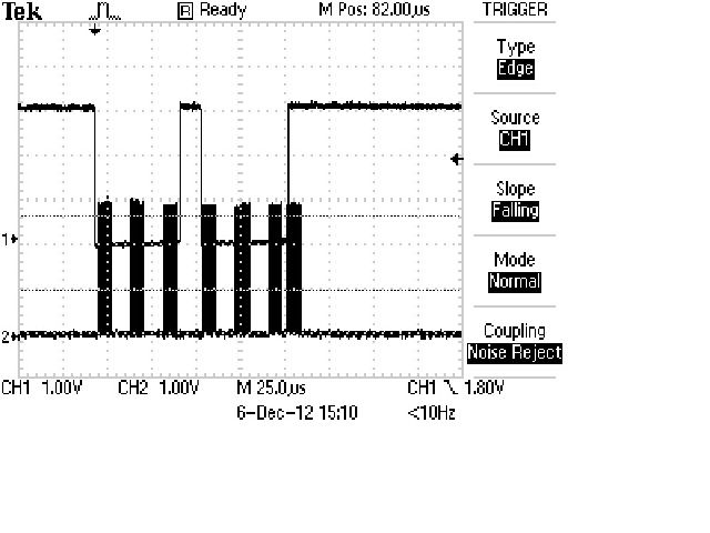

Hi all,
To read or write a register of ADS1298 I need to write 3 byte on SPI bus and I need some delay between every byte. Based on the discovery example I write the following read and write routine:

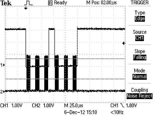

When I tested these two routine reading and writing the ADS1298 register I found that sometimes I have 16 clock cicle on the bus while I setting the SPI size at 8 bit (see Below)
// ADS1298 CPOL bit is a '0' and its CPHA bit is a '1'.
SPI_I2S_DeInit(SPI1);
SPI_InitStructure.SPI_Direction = SPI_Direction_2Lines_FullDuplex;
SPI_InitStructure.SPI_DataSize = SPI_DataSize_8b;
// SPI_InitStructure.SPI_DataSize = SPI_DataSize_16b;
SPI_InitStructure.SPI_CPOL = SPI_CPOL_Low;
SPI_InitStructure.SPI_CPHA = SPI_CPHA_2Edge;
SPI_InitStructure.SPI_NSS = SPI_NSS_Soft;
SPI_InitStructure.SPI_BaudRatePrescaler = SPI_BaudRatePrescaler_8;
SPI_InitStructure.SPI_FirstBit = SPI_FirstBit_MSB;
//SPI_InitStructure.SPI_FirstBit = SPI_FirstBit_LSB;
// SPI_InitStructure.SPI_CRCPolynomial = 0;
SPI_InitStructure.SPI_CRCPolynomial = 7;
SPI_InitStructure.SPI_Mode = SPI_Mode_Master;
SPI_Init(SPI1, &SPI_InitStructure);
Could someone help my to find the root cause of this wrong SPI behaviour?
I sperimentally found that if I set the SPI first bit with LSB the problem disappear.
Thanks
Luca
Below the oscilloscope image. On ch1 there is the CS while on ch2 there is the SPI Clock
Write Register correct
Write problem
READ CORRECT
READ PROBLEM
2 REPLIES 2
