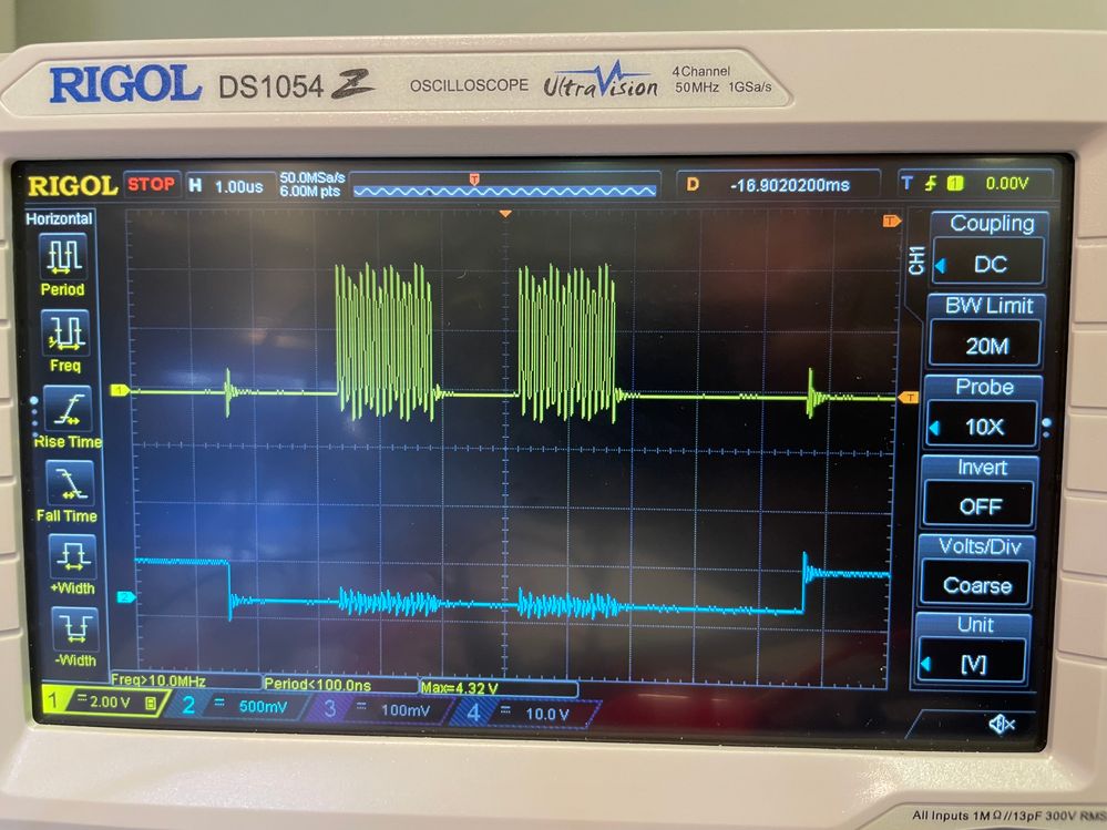

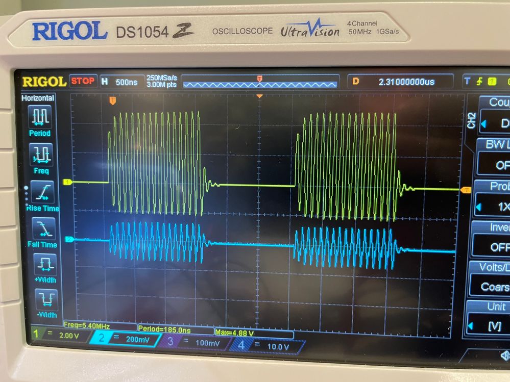

I am try to control an external DAC system with the SPI interface. The clock signal shape looks like the attached file. I didn't figure out the meaning of the signal. Yellow is the clock signal and the blue is CS signal.0693W00000aJE10QAG.jpg

I pressed the CLEAR and AUTO, now the sampling rate is 250 MSa/s with 300k pts.
The bandwidth of the isolator is 25 Mbps
Is the signal on the STM32 side clean? Not ringing?
If the traces are short, ease back the slew-rate via SPEEDR settings.
What speed is your SPI clocking at?

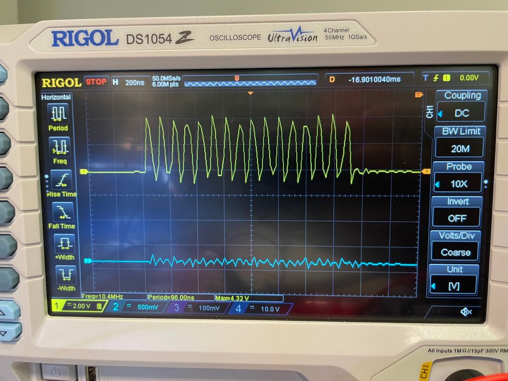

Now the updated signals look like the attached figures (the isolator removed).
The SPI Baudrate 10.5 Mbits/s.0693W00000aJEfjQAG.jpg

AScha.3
better.
probe still at x1 ! you cannot test cmos connections at > 10MHz with x1 probe setting.
set x10 at probe switch and in scope menu.
AE104
Senior
I set the 10x both the probe and settings in the oscilloscope.
AScha.3
x10 probe setting needs adjustment - did you adjust ?
+ BW limit 20 M is set.

No game. What adjustment do I need?
AScha.3
bw limit off.
and adjust probes - i hope you know how to do.
