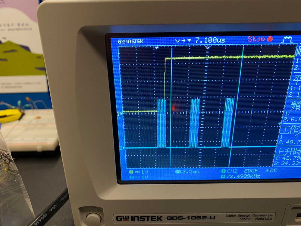

I am having problems with STM32C8T6 interfacing with TI ADS8317.

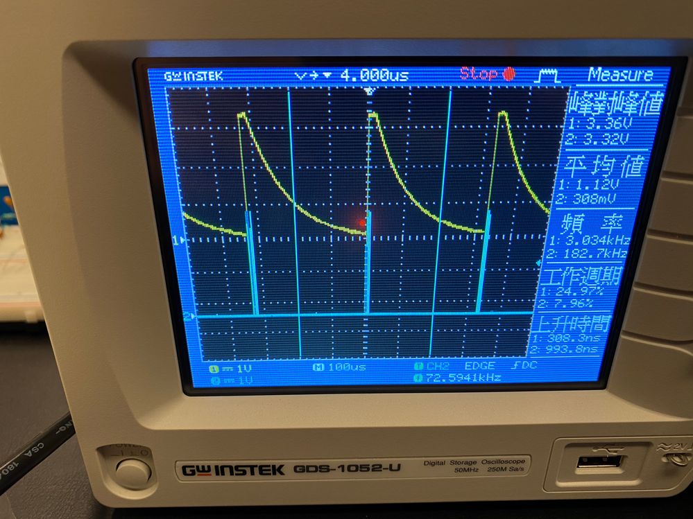

  1. Long tail at SDO line (first & second image)
  2. The seperation time between each byte is always significantly long (not sure if this is a problem) ( second image)
0693W000006EMfSQAW.jpg0693W000006EMgpQAG.jpgSecond image is the enlargement of the first.
The code responsable for this is simply:
 HAL_SPI_Receive(&hspi1, tempADCdata, 3, 1); //tempADCdata
The setting is as follow:
SPI: Full Duplex Master
Bit rate: 6 Mbits/s
CPOL: 0
CPHA: 0 (rising edge)
Could you kindly point me to potential solution to solve the above issues?

waclawek.jan
> STM32C8T6
Which one is that, exactly?
I assume you are talking about MISO line.
Why would that be a problem? There are no clocks during that time, so nothing is read.
You can try to switch on a pullup on the MISO line.
It's you who can judge if it's a problem. The ADC appears to have a relatively wide tolerance for clock, so as long as the longest period (i.e. adding the inter-character gap) converts to above the lowest allowed clock frequency, it should be OK. But I personally would try to avoid it.
Don't use Cube, write your own routine to send/receive. Use higher compiler optimization settings.
Uwe Bonnes
Principal III
It seems the line is tristated.
