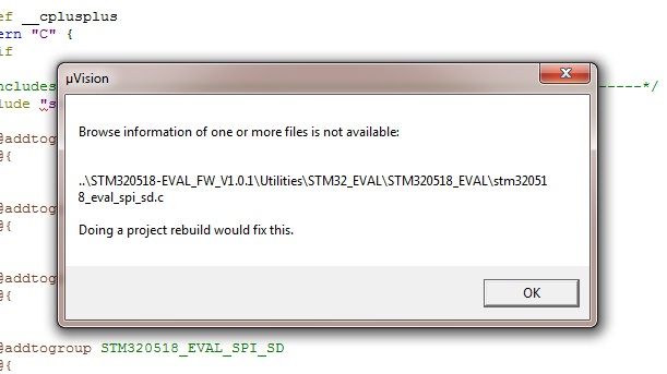

Dear Sir,
Can you advice me how should I include ''stm320518_eval_spi_sd.c and '' stm320518_eval_spi_sd.h'' files to my project. I am using STM320518-EVAL_FW_V1.0.1 ''I tried several manner but it is giving errors- Mark as New
‎2015-01-18 5:40 AM
You can't right click or float on things until the editor has browsing information generated by a compiler pass.
Focus on the errors generated during the build process, starting with the first ones.Up vote any posts that you find helpful, it shows what's working..

Dear Sir
Only one Error is showing, which is..\STM320518-EVAL_FW_V1.0.1\Utilities\STM32_EVAL\STM320518_EVAL\stm320518_eval.h(39): error: #5: cannot open source input file ''stm32_eval_legacy.h'': No such file or directory- Mark as New
‎2015-01-18 6:58 AM
Which would seem to be indicative that you haven't set up the compiler's include paths sufficiently to capture the needed files, or copied/ported the files to your own project directory(s).Up vote any posts that you find helpful, it shows what's working..

But it's complaining about another file, stm32_eval_legacy.h, which you evidently didn't copy, or suitably path.
‎2015-01-19 7:18 AM
Dear Sir,
