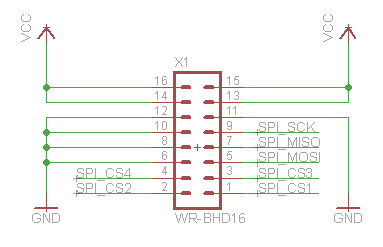

I have to mention, that I use a ~45cm ribbon cable to connect the SPI master to the slaves, which I know is not really state-of-the-art. However, the signals look well on oscilloscope and logic analyzer. The layout of the ribbon cable is: CS-GND-MOSI-GND-MISO-GND-SCLK-GND.

Hmm....All boards are supplied from the same V_IN via ribbon cable (the same, that also carries the SPI data lines; 4 wires in parallel for bigger cross section). The VCCs are generated separately by the onboard voltage regulators and not necessarily 100% in sync...
(VCC here is connected to V_IN of the Nucleo boards)

There is no additional circuitry on the SPI lines, 1:4 direct connection of SCLK, MOSI and MISO without termination. Only for the CS there is some logic gates to make the slave address configurable via DIP switch.

The answer is that the VCCs are NOT sync'ed. Using the laws of current flow, the boards will attempt equilibrium by pushing and pulling current through your IO lines. Unless you have made allowances for this in your design, this WILL put undue stress on the IO lines. Is it enough to over-stress - that is a matter of luck!!!
It is unfortunate that ST doesn't publish enough on this subject to allow for informed choices.
However, the subject is common to CMOS fabricators. You will find that sites like www.ti.com, www.nxp.com, and others are much more informative on the subject of Latch-up...
