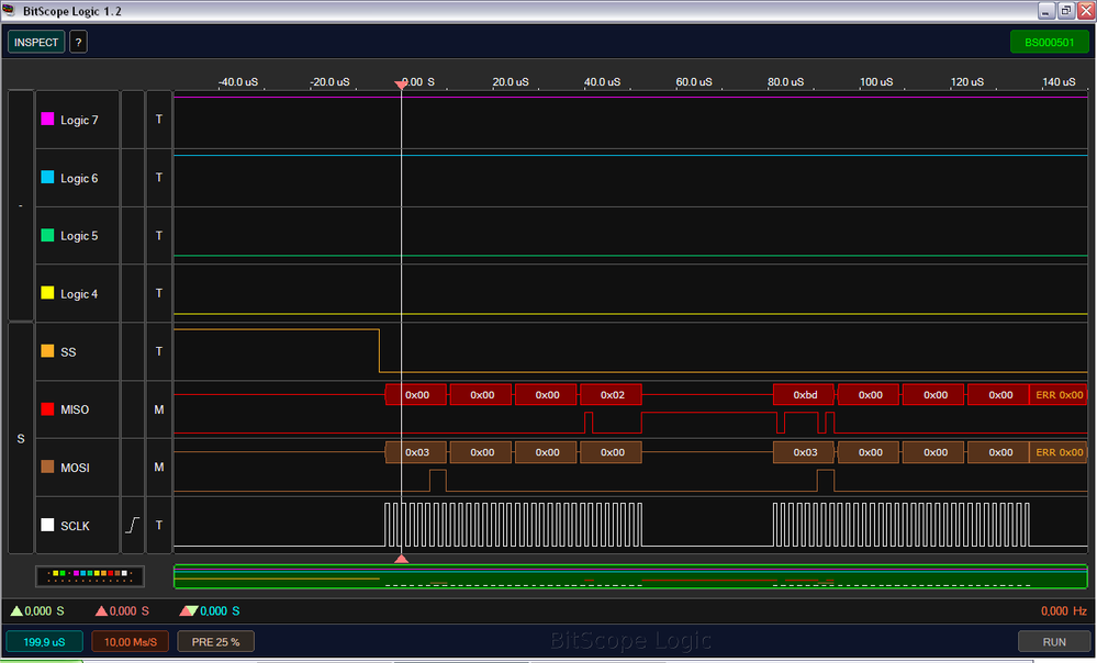

I had to face the same problem, but on the STM32F105, SPI master + DMA and hardware NSS.
Before I had found the issue it looked like this
After reading the discussion I realized that disabling the SPI in DMA callback resolves the issue.

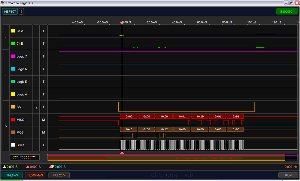

After that transmission looks like this.
I hope it will help you.
