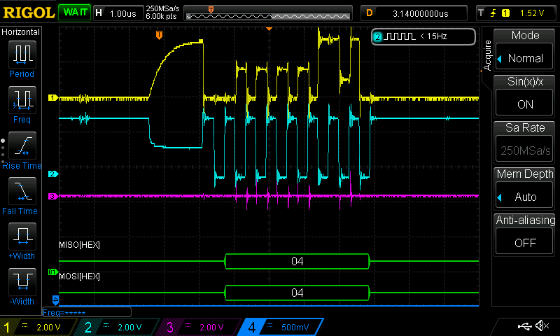

then it sends 16-bits clock even if I specify the size to be 1 byte
and if I send a unsigned char u8test instead of an array,
volatile U8 u8test= 0;
it sends 8-bits clock correctly but with incorrect voltage on the line :
waclawek.jan
The SPI starts to clock as soon as you turn it to receive and stops clocking when you turn it to transmit again. It's up to you to ensure the timing, it's not trivial and I don't believe Cube/HAL helps with this in any way.
You may want to bit-bang the protocol, if the extra clocks are an issue.
I don't know why the voltage on data line is incorrect, this may be due to the device on the other end of the line, too. Insert a resistor and measure at both ends to find out which "party" pulls the line to which level.

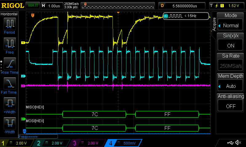

stéphane rey
Thanks for your feedback again.
I'm quite puzzled with what happens on a simple SPI peripheral....
With the following code :
    SPI_1LINE_RX(&hspi2);  // BIDIOE = 0
    u8SPIerror = HAL_SPI_Receive(&hspi2, (U8*) &u8test, 1, 10);
    SPI_1LINE_TX(&hspi2);  // BIDIOE = 1
what I see in step by step is that the clock is sent once I turn BIDIOE to 1 again and not before. It sounds strange to me but ok as I was expecting it would happen when turning BIDIOE to 0.
And then the number of clock bits as well as this strange levels on MOSI depends on the variable type for the buffer. If I set this buffer as an array of unsigned char I do receive my slave data (7C) but with an extra SCK byte whatever is the buffer length for which my slave do not take care, but if I change my buffer variable to a single unsigned char then I have the correct number of SCK bits but MOSI just get weird signals...
