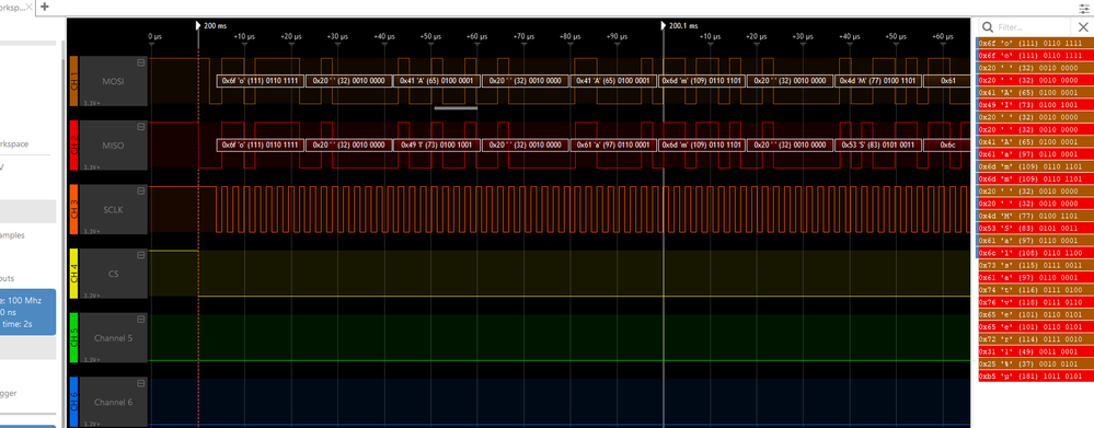

THE PROBLEM:
When both tx bufferts consist of "hello", everything works fine, but when i change it to "hello, THIS IS MASTER TESTING" / "hello, THIS IS SLAVE1 TESTING" i.e same sizes on both "sides"
the data is currupt and I only get part of the message(parts like "lo, " and then rubbish )
Anyone who has an Idéa on this?

Are the clocks exactly the same? Might want to make sure the slave clock is 2x of the master.
Can you see what's happening on the line? Logic analyzer or scope?

Do you mean by setting prescaler? Changed it to this:
Master has setting pSpiHandle->Init.BaudRatePrescaler = SPI_BAUDRATEPRESCALER_128;
Slave has setting pSpiHandle->Init.BaudRatePrescaler = SPI_BAUDRATEPRESCALER_32;
but without improvement,
I also set GPIO speed for slave to GPIO_SPEED_FREQ_VERY_HIGH
Please see picture below from logic analyzer reading
The message is definitely improved but some letters are off and the start of the message is cut of for some reason
The messages sent is: "hello I am Master" and "hello I am Slave1"
Yes, exactly. The trace looks perfect, except that it’s not sending what you want. Not sure. I dont see any issues in the code that you posted. I would guess the issue is elsewhere.
MBohm
The intresting thing is that while the trace looks like this, the message that gets put in the Rx buffer is "o\0\0\0 \0\0\0I\0\0\0 am M"
Could it have something to do with dma buffert/burst/memInc or datasize?
Turning DMA off, i.e. using HAL_SPI_TransmitReceive() instead of HAL_SPI_TransmitReceive_DMA() results in Rx buffer containing "hello I am SlavSe"
A great improvement but still not perfect.
But still, DMA settings seems to have something to do with it.
