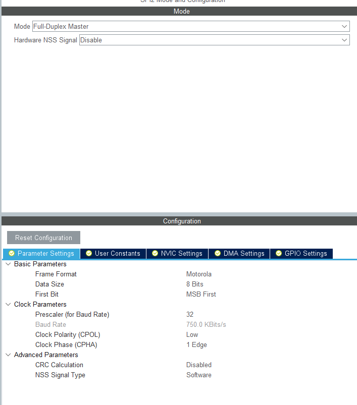

Here is the config for the SPI in master mode.

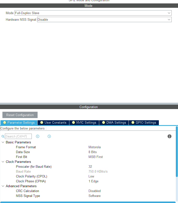

And this is config of SPI in slave mode.

Master side:
counter = (counter > 4) ? 0 : counter;
HAL_SPI_Transmit(&hspi2, (uint8_t *)&UID[counter], 1, HAL_MAX_DELAY);
HAL_Delay(1000);
HAL_SPI_Receive(&hspi2, (uint8_t *)&txBuf[counter], 1, HAL_MAX_DELAY);
HAL_Delay(1000);
counter++;
Slave Side:
HAL_SPI_Receive( &hspi2, (uint8_t *)&rxBuffer[counter], 1, HAL_MAX_DELAY);
HAL_Delay(1000);
HAL_SPI_Transmit( &hspi2, (uint8_t *)&uid[counter], 1, HAL_MAX_DELAY);
HAL_Delay(1000);
counter++;
Its pretty simple, where master is sending 5 bytes (one by one)
and Slave is sending 5 bytes (one by one) but its transmitting after it has received successfully.
