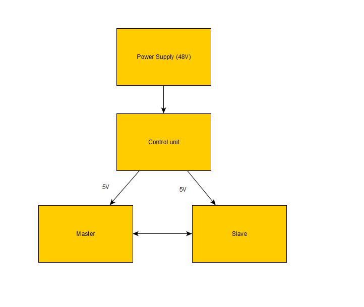

Currently I am using STM32F303CBxx as my slave and an Infineon microcontroller as a master. The communication takes place via SPI with the clock frequency as high as 1.985 MHz (approx.). The master and slave are inside a closed metal compartment, where one of the control unit consumes higher amount of current, as high as 35 A.

What is the power source ? -> Power source is from a standard power supply with 48V input to the control unit. It steps down the voltage to 5V, which is used to power the sensor (slave). The slave has an 3.3V LDO, which is used to power the microcontroller. A similar setup is used on the master side as well. Since the master and the slave are spaced out by a distance of around 15 cm, individual LDOs are used.

Can you shed more light on the mystery 35A load and how is the power adjusted and switched ?
Clearly the the load or its controller is creating some sort of pulse interference.
RE: control unit is consuming high amount of power
Is your control unit a high power (1600W) computing device or a motor drive ?
Also in the above block diagram the slave should take 5V power and ground from the master

At this stage its our assumption that the ground planes might be improper. Is there any possible way to detect this? Suggestions are welcome..
