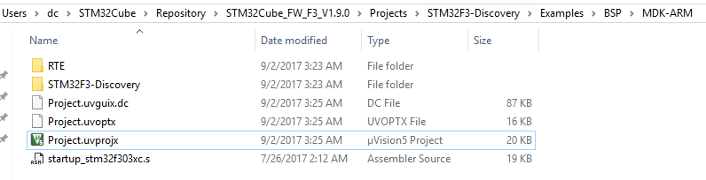

Inside your F3 firmware there is an example using the L3GD20H for 303 discovery board
It uses HAL and its a good starting point to make your project

Posted on September 02, 2017 at 10:43
Thank you for responding.
Perhaps I am to novice to learn from this example. It seems a bit complex.
