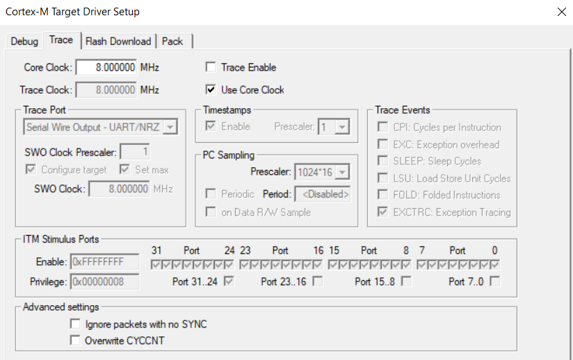

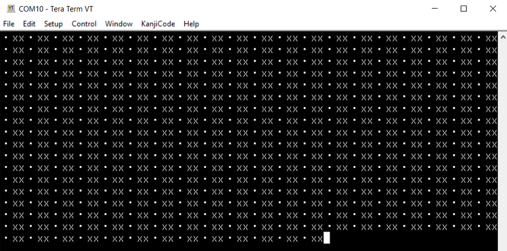

Thanks TDK. Yes, my values at GPIO-> AFR gets over written and so I have deleted the part related to RX as I dont need it yet at this point. I am just trying to output a character to serial monitor. Now I have cleaned up the code and I am able to see some characters displayed but it is no where near the expected characters. For BRR calculation I have used the formula usartdiv = ***/(16*baudrate) where *** is 8MHz (XTAL freq). I have read read somewhere that I should use the APB2 bus clock instead which in my case is 80MHz. I have tried using this but I dont see any output at the serial monitor. I am using the BL475E-IOT01a board.
The delayMS function was copied from the tutorial I was using so it should somehow work. I just use his code as reference as he was using a different stm32 chip. Another thing, in keil target options, what shoudl i use as value of core clock? is it 80MHz?

I have used the formula usartdiv = FClock/(16*Baudrate) for a value of 0x341 at 80MHz, 9600 baud for BRR. Serial monitor output will then just be a bunch of ff ff ffs ....
B.Redmoon
I finally got to make it work. In L475 chip, default core clock is 4Mz. usartdiv = Fclock/9600 for a value of 0x1A0.
USART1->BRR = (0x1A0);
