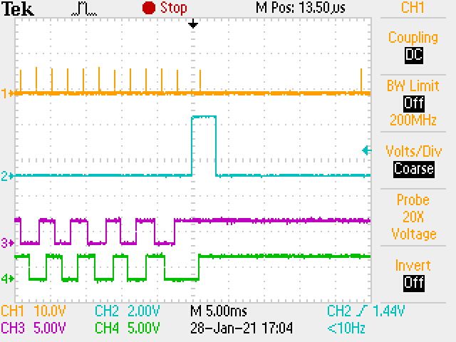

I have played with the TIM1 in Encoder Mode for a bit (based on several tutorials out there), and have scoped out the encoder's Channels A and B to see what the Quadrature Encoder signals look like. Here is a reference image:
0693W000007DhROQA0.jpgIn the image above, purple is Channel A, green is Channel B, and yellow indicates STEP signals (going into a motor driver that will increment the motor), and the blue signal indicates DIR (direction of rotation, where high indicates counterclockwise rotation, and low indicates clockwise rotation). The DIR output from the microcontroller also goes into the Motor Driver.

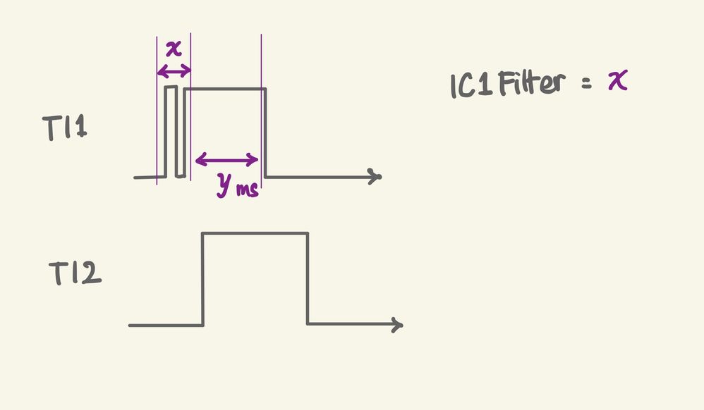

From what I am understanding regarding your explanation on the ICxFilter, if I have for example some noise on the TI1 channel similar to the diagram below, where TI1 seems to have noise before settling for around y milliseconds, and the IC1Filter = x, seems to observe TI1 at the time period where TI1 was unstable:
0693W000007E2fgQAC.jpgThe TIM1->CNT register will only count 3 pulses (one rising edge from TI2, and two falling edges from TI1 and TI2) and will only reflect 3 increments, even though TI1 goes high (and is stable at high) for y ms after the noise? Is my understanding correct?
Or, since the rising edge was disregarded, the time TI1 was high will be completely disregarded (STM32 will see TI1 as just flat 0V), and the TI2 pulses would also be ignored and considered as jitter since TI1 is flat? This would mean that TIM1->CNT did not increment at all?
