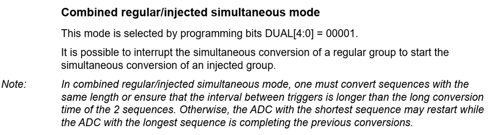

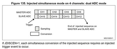

There are a lot of questions (Question are all refering to "Injected simultaneous mode") that cant be answered, or details that are confusing:
- When in Injected simultaneous mode, regular conversions are possible, but use the settings of the common registers for dual settings?
- Picture "say what": It does not really say how it would behave in that case.

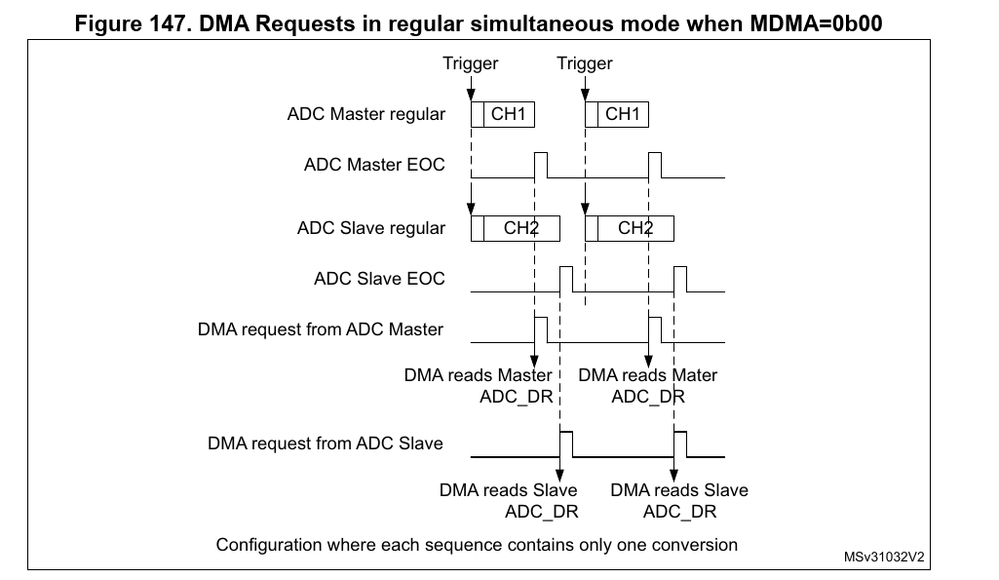

- With all the information i gathered, i can not really determine, how the ADC would work in combination with DMA. When i start regular conversions on ADC2, is it then considered dual mode?
Same way, as on other cpus , just more complex than on an old F103 (DMA + MDMA ),
maybe read the 120 pages of ADC in rm ... or use HAL for making it more easy.

You have posted a picture of the wrong mode. Yes, its confusing sometimes.
