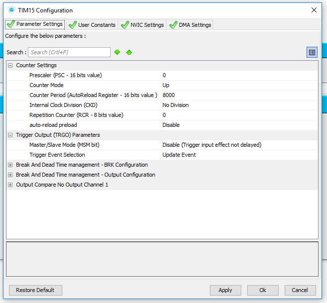

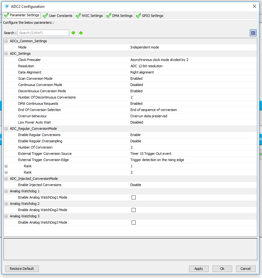

Posted on March 15, 2018 at 16:14
This is what my example does. I am using TIM15 to create a trigger for the ADC using the Update Event. This then causes the ADC to sequentially reads 2 channels and uses DMA to put the results in memory. After a number of the DMA sequences have happened I process the data.
