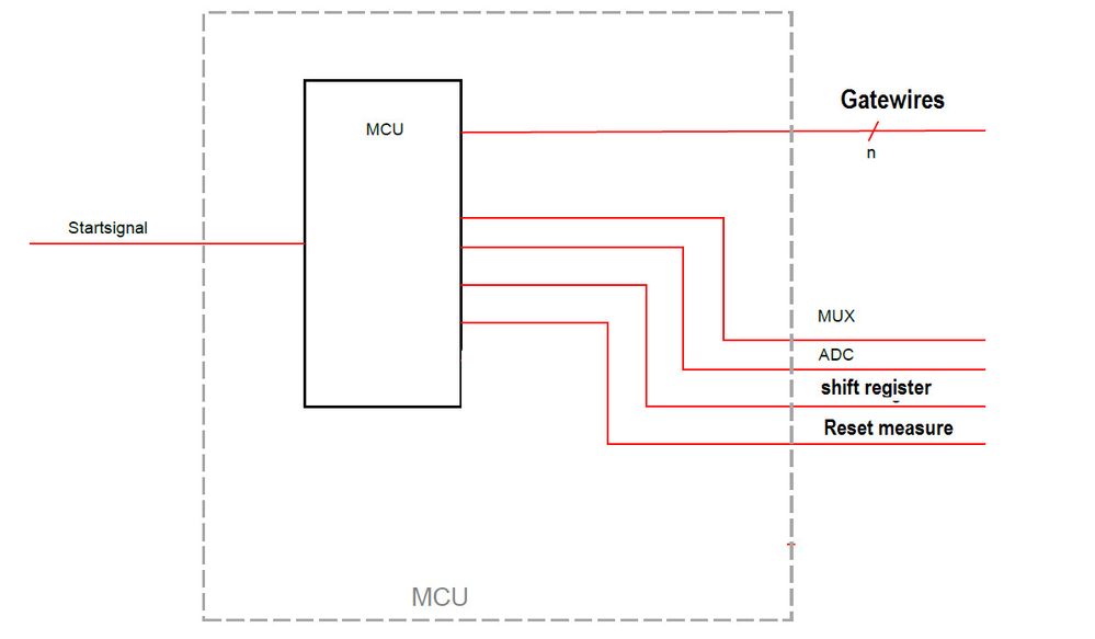

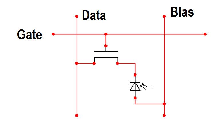

BWolf
​Hi I'm sorry for the incomplete Information.
For a project in university I should build a 'Flat panel Imager' to measure x rays or other radiations depending on wave length of the light.  ( Measuring it with a Photodiode).
Therefor a 4x4 Matrix of Photo diode should be triggered over Thin film transistors.  with four outputs of µController I wanted to set that one of the 4 rows is  readout and with the readout of one of the of Data columns.  I have a attached a Image for that (Image 2).
After that the data should be saved in a integrator (OP), the reset should be done with an output of the MCU. Before reseting the data should be processed with a ADC and shiftet to a serial signal. The serial signal should be displayed then. (maybe an LCD panel or something)
Thatfor I want to know is there any discoveryboard with some of the wanted parts already connected? If not what would be a appropriate?

waclawek.jan
Without any particular requirement eg. for speed, any STM32 would probably fulfill these requirements.
Diplaying on LCD is probably best done on a higher-end STM32, such as the 'F429 or 'F746. On the other hand, if you chose a LCD with controller with moderate pixel size and don't want any fancy high speed operation, any mid-range mcu would do.
