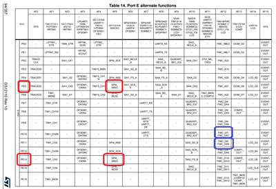

I am planning to use SDR SDRAM on my custom board. And i am not sure if can swap bits within bank or swap bytes between banks. To get to the point what i meant by "they are fixed", in CubeMX when you press Ctrl + Left Button of mouse, CubeMX shows you alternative pin assignments of your clicked pin. For example PE5 is SPI4_MISO, when i press Ctrl + Left Click of mouse, CubeMX indicate that PE13 is also can be assigned as SPI4_MISO. But for SDRAM, there is no alternative for FMC_D8 or FMC_D7. So that makes me think that, what if it is not possible to swap bits or bytes?
This is not a question of CubeMx but that depends on the availability of the alternate function on a given IO. This information is given in the datasheet / table 14:
For example The SPI4_MISO is available on two IOs: PE5 and PE13 while FMC_Dx are available only on one I/Os.
According to the swapping function you are looking for (according to the link you shared) it's something linked to the PCB to decrease the vias, which is something you need to do with the layout.
