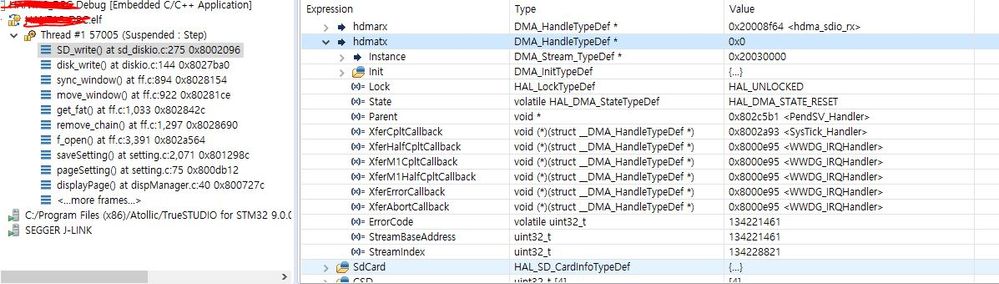

At the first time, SDIO works well but 10~20 minutes later, when i try to open a file(FA_CREATE_NEW | FA_WRITE options), there is no answer for 30 seconds and then SDIO does not work anymore after being shown FR_DISK_ERR.
Through debugging, I found that SDIO doesn't work as soon as the osMessageGet called on SD-Write function (osMessageGet result is osEventTimeout).
This problem disappears when the SDIO clock speed is lowered (ClockDiv is 8 or more). However, the Read/Write speed get very slow too much than i want.

    About 5~ minutes later SDIO_IRQHandler is called although i do not use SDIO. And i found that HSD state is changed as above.

    The error can be pinned to an exact location in the code:
    After the DMA transfer is started (HAL_SD_WriteBlocks_DMA), the related callback (HAL_SD_TxCpltCallback) never arrives. Therefore a timeout happens.
