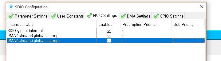

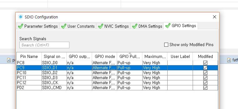

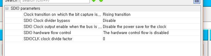

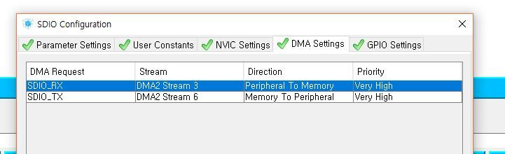

Hi.
At the first time, SDIO works well but 10~20 minutes later, when i try to open a file(FA_CREATE_NEW | FA_WRITE options), there is no answer for 30 seconds and then SDIO does not work anymore after being shown FR_DISK_ERR.
Through debugging, I found that SDIO doesn't work as soon as the osMessageGet called on SD-Write function (osMessageGet result is osEventTimeout).
This problem disappears when the SDIO clock speed is lowered (ClockDiv is 8 or more). However, the Read/Write speed get very slow too much than i want.
STM32F429 use
CubeMX 4.25.0
STM32CubeF4 Firmware Package v1.21.0
FreeRTOS 9.0.0 (CMSIS 1.02)
FatFS R0.12c
SDIO Settings (DMA used)

Getting there - thanks for setting me on the right path. There is indeed a spurious 'timeout' that breaks everything. This timeout is clock-speed dependent - that's probably why the OP didn't observe the problem with very slow SD clock - the problem was just very delayed. In my case, 48 MHz clock results in timeout during 01:30 minutes of idle. 24 MHz clock changes that to 3 minutes. I had SDMMC_HARDWARE_FLOW_CONTROL_ENABLE. This 'feature' caused the SD clock line to hang itself high and dry (in order to allow the DMA to catch up, apparently), forever, whenever the spurious timeout occurred. Looks like this feature is too dangerous when used alongside DMA, and most likely unneeded anyway.
It would be great to resolve why this timeout happens (SanDisk xtreme 32 GB, 0xffffffff programmed timeout), but I could work around it by disabling interrupts at the end of SD_DMAReceiveCplt(), and then by clearing all interrupt flags just before re-enabling the interrupts in both HAL_SD_ReadBlocks_DMA() and HAL_SD_WriteBlocks_DMA(). Would gladly post the code if anyone would find it useful - unfortunately the latest CubeMX code appears to have not been tested at all, and needed a lot of changes to sd_diskio.c (this is the version that uses message queues), bhp_driver_sd.c and even LWIP, to force its ram_heap to be DMA-friendly...
