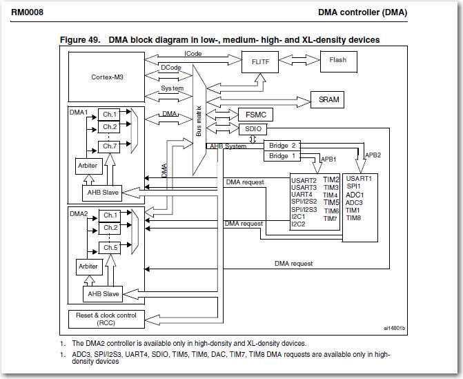

Guys,
I have a question about SDcard and LCD initialization , Everytime I intialize LCD after SDcard, SDcard stopped working, is it because of port clock ? Thanks SDcard initialization :

Posted on April 16, 2014 at 15:25
Is it possible for DMA conflict between SDIO and FSMC, since SDIO is using DMA channel4 ?...
I don't know, what do you think the conflict would be? Is there some documentation that suggests there is? Are you DMA'ing from the SDIO to the FSMC external memory. Debugging should have to be about random guessing.
Your FSMC configuration is broken, if your read/write parameters are actually different you need to create TWO descriptors, calling FSMC_Init() twice doesn't work that way.

antonius
Senior
Posted on April 17, 2014 at 01:09
For now, I fixed it by using only one configuration for read and write for FSMC, now I can initialize LCD before SDcard and it's working allright.....thanks
