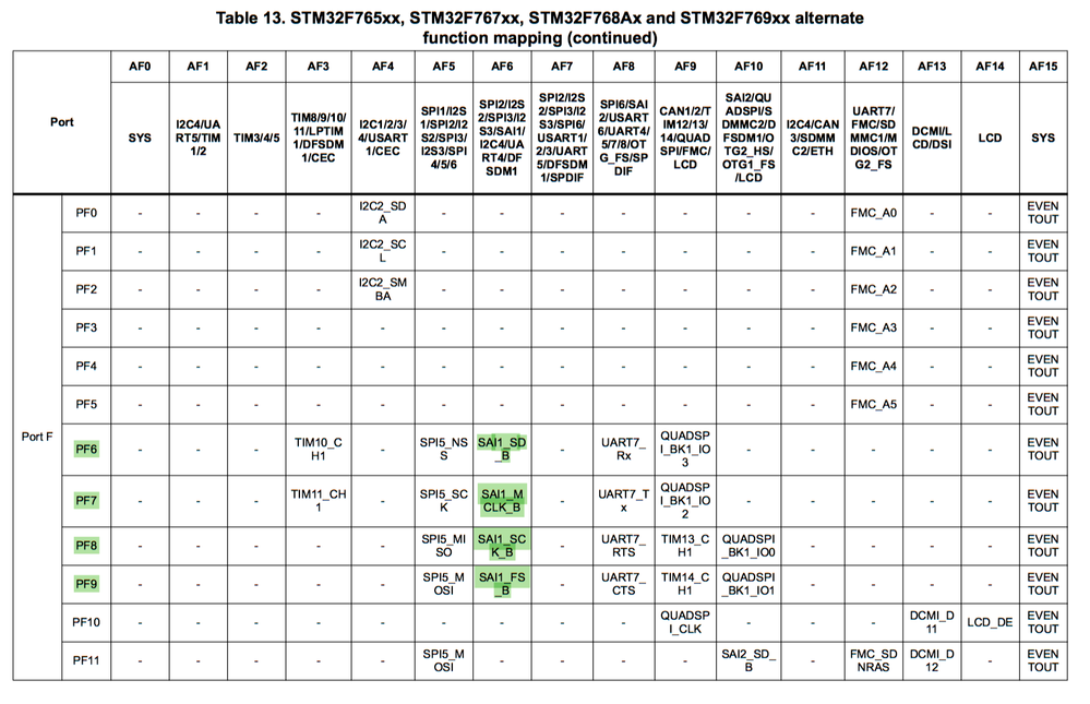

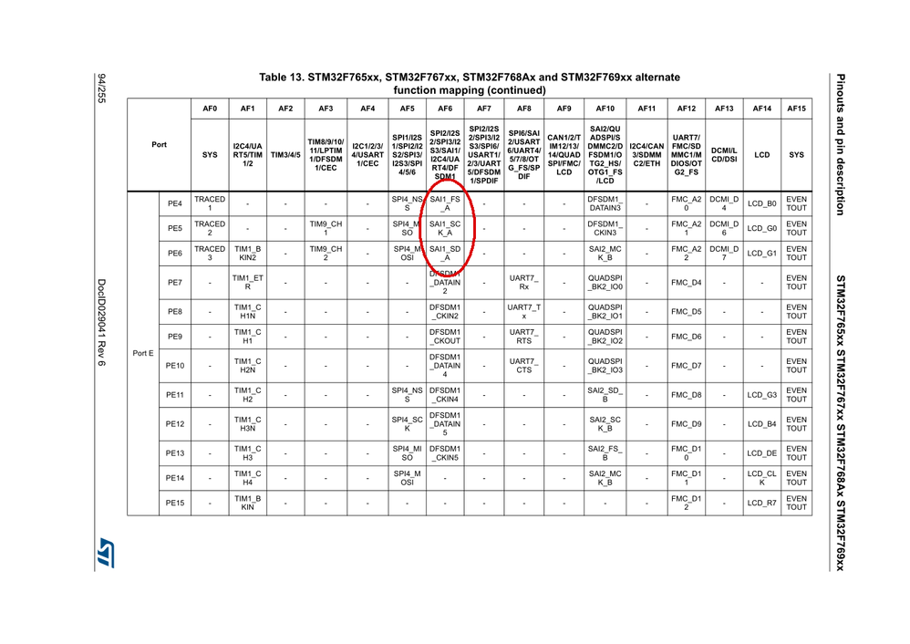

I am trying to change the SAI IO pins on the STM32F769_Discovery board using the SAI example.
You cannot assign function block signals to arbitrary pins of the mcu, see the Alternate function mapping table in datasheet, for example:

my pin SAI_B pin assignment is like this..
/* SAI peripheral configuration defines */
♯ define AUDIO_SAIx SAI1_Block_B // CHANGED TO Block_B from A !
♯ define AUDIO_SAIx_CLK_ENABLE() __HAL_RCC_SAI1_CLK_ENABLE()
♯ define AUDIO_SAIx_FS_GPIO_PORT GPIOF
♯ define AUDIO_SAIx_FS_AF GPIO_AF6_SAI1
♯ define AUDIO_SAIx_FS_PIN GPIO_PIN_9 // PF9
♯ define AUDIO_SAIx_SCK_GPIO_PORT GPIOF
♯ define AUDIO_SAIx_SCK_AF GPIO_AF6_SAI1
♯ define AUDIO_SAIx_SCK_PIN GPIO_PIN_8 // PF8
♯ define AUDIO_SAIx_SD_GPIO_PORT GPIOF
♯ define AUDIO_SAIx_SD_AF GPIO_AF6_SAI1
♯ define AUDIO_SAIx_SD_PIN GPIO_PIN_6 // PF6
♯ define AUDIO_SAIx_MCLK_GPIO_PORT GPIOF
♯ define AUDIO_SAIx_MCLK_AF GPIO_AF6_SAI1
♯ define AUDIO_SAIx_MCLK_PIN GPIO_PIN_7 // PF7
♯ define AUDIO_SAIx_MCLK_ENABLE() __HAL_RCC_GPIOF_CLK_ENABLE()
♯ define AUDIO_SAIx_SCK_ENABLE() __HAL_RCC_GPIOF_CLK_ENABLE()
♯ define AUDIO_SAIx_FS_ENABLE() __HAL_RCC_GPIOF_CLK_ENABLE()
♯ define AUDIO_SAIx_SD_ENABLE() __HAL_RCC_GPIOF_CLK_ENABLE()

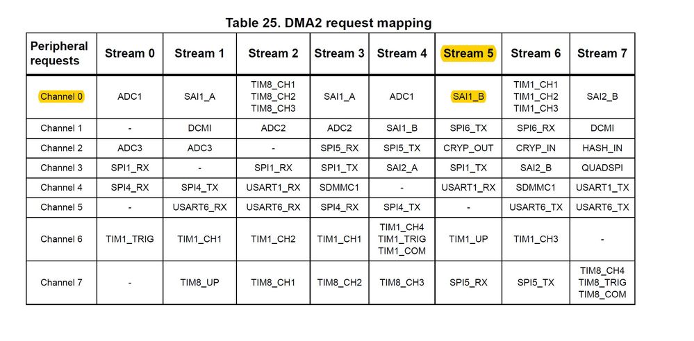

for anyone else trying the same thing , I changed DMA to stream5 after seeing this DMA map
I'm using SAI1_B
 hSaiDma.Init.Channel   = DMA_CHANNEL_0;
add to stm32f7xx_it.c
void DMA2_Stream5_IRQHandler(void)
HAL_DMA_IRQHandler(SaiHandle.hdmatx);
SAI WORKING in SAI example on external pins.
I don't think there is a pin available for stm32f769i_discovery on SAI1_blockA for SD input.
I might have to solder a bodge wire onto a Test Point for SAI SD input or maybe I find a way on SAI2.
Anyway , I understand now you need to use / assign pins mapped to SAI ports and use the correct DMA stream and Channel for SAIx.
