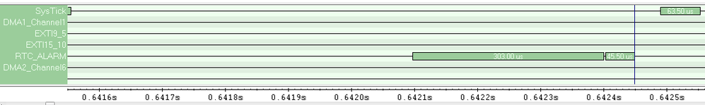

I have 2 PCB with STM32L476. The same code is running on each PCB (both board have been programmed with the STlink-utility and the same binary file). The RTC is configured to provide a 1Hz IRQ. The RTC clock is the 32kHz LSI.
On the first PCB, the RTC is working perfectly since months.
***On the second PCB, the RTC was working up to tonight, 3AM.***
The RTC provides something like a 2Hz IRQ with a lot of jitter :
- First IRQ @ T0 + 656ms
- Second IRQ @ T1 + 566ms
- Third IRQ @ T2 + 746ms

The timeline provided by IAR shows a double IRQ...
At this point I do not understand anything anymore... Thank you for your help

Don't see any IRQ code.
Presumably this is a system being actively debugged/traced? Can you output useable telemetry without that? ie time stamp against DWT_CYCCNT or a 32-bit timer running at 1MHz or core speed, output to serial terminal. GPIO to a scope, etc.
The LSI (+/-5%) isn't exactly what I'd call stable, at least on the other STM32 I've used. Not using L4 here. Also going to be sensitive to supply voltage.
