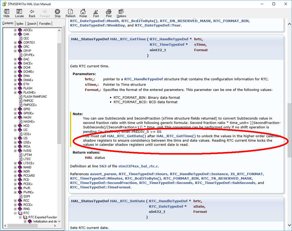

waclawek.jan
Posted on June 15, 2017 at 17:23
Have you read the manual?
And read RM0090, 26.3.6  Reading the calendar.
Posted on July 03, 2017 at 02:27
Hello
Waclawek.Jan
by the way, i want to ask you about this manual, from where did you get this format (*.hlp or *.cnt) ? (like in the screenshot)
all documents that i have are in pdf format!
thanks !!
Farouk
Posted on July 05, 2017 at 23:52
Farouk,
this screenshot is from [STM32Cube_FW_F4_V1.4.0]\Drivers\STM32F4xx_HAL_Driver\STM32F417xx_User_Manual.chm
Jan
Posted on July 09, 2017 at 07:53
Big thanks Jan,
Farouk
