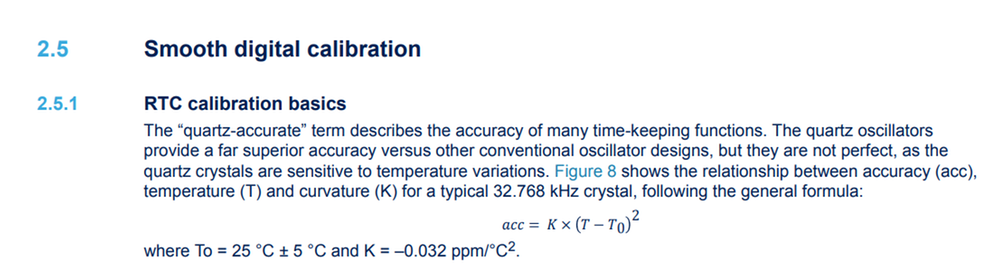

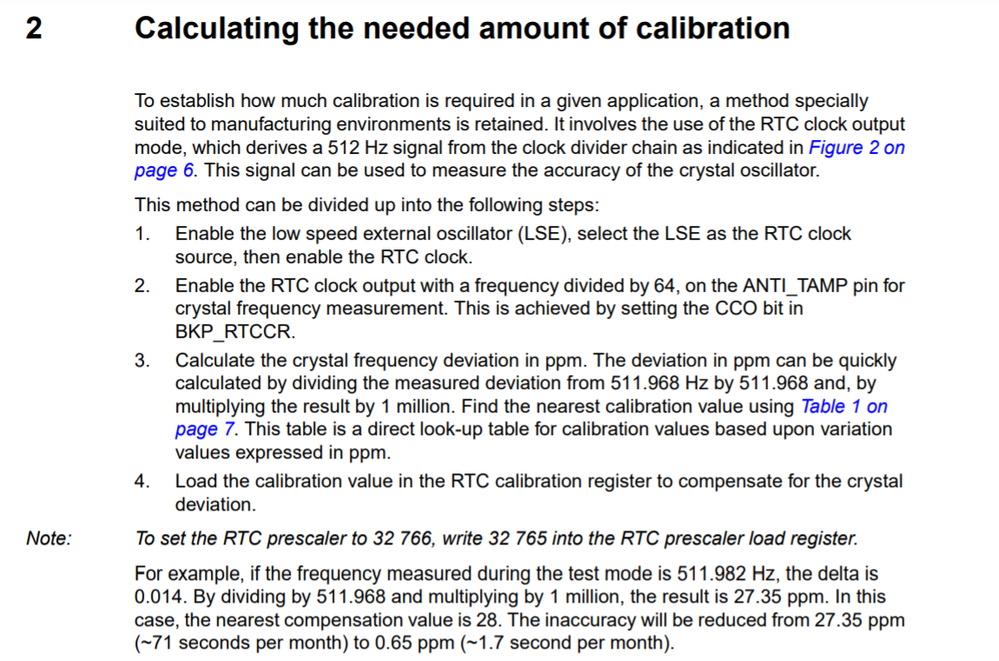

I dont know how to calibrate rtc by temperature, i confused. When I look at RTC smooth calibration method like this, I thouht that i understand. After that i encountered AN2604 application note and i confused again.
I cannot understand 2nd section in AN2604. How to calculate 512Hz ?
Do I measure RTC Calib output( 1Hz or 512 Hz )?
Any practical advice , make me happy so much.
Yes. Some STM32 allow to output LSE on MCO/LSCO pin, if you use such, you can use that pin, too. It is expected that you have a precise timebease and precise enough instruments to measure 1Hz/512Hz/32768Hz with precision you require (i.e. a few ppm).
Then you calculate the deviation between expected (say 512Hz) and actually measured frequency, and use that to calculate the required value for the calibration, as described in the RTC chapter of RM for your STM32.
Don't try to measure frequency *after* applying calibration, unless you exactly know what are you doing (you have to measure it across the whole window where the calibration is applied, typically 32s) else you will get confusing results.
AN2604 is for STM32F1xx. RTC in 'F1 is different from all other STM32 models, so the description there may be confusing. Read AN4759.

Could you please guide me for temperature calibration. I have read AN 4759 and I still confused . I dont know how can i integrate graph ?For example i calculate this acc value for me but how will i continue ?

acc is the error in ppm for given temperature. Note, that the formula and values above are only examples and don't necessarily apply to your particular crystal and setup.
Now you take that acc value for any given measured temperature, and use it for the smooth calibration, as described in the RTC smooth digital calibration subchapter of RTC chapter of RM for your STM32.
