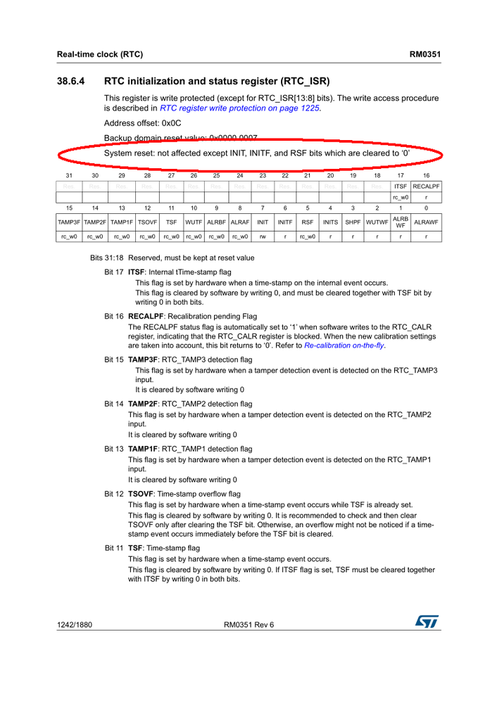

Can I know whether it is due to alarm A or alarm B.
when it wakes ups from standby, it is as good as start from reset. so all flags reset to default. so cannot check ALRAF or ALRBF.

ALRAF/ALRBF are not affected by System reset, so unless you perform a Backup domain reset, they should remain set reflecting which alarm was invoked.
