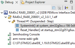

I was writing some code and one day a handler_reset() appears in the debug panel
It is said that appears because it give the opportunity to the user to debug from the very begining. But why? if there is already the ability to set the breakpoint in the main...

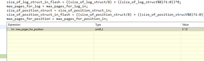

I cannot assign a value to a variable.
And the other things is the fact that since it has appear I cannot longer debug and the variables make no sense. What causes all that and which is the solution??

Solved!!
if you are using pemicro multilink universal #ifdef #endif your IWDG.
