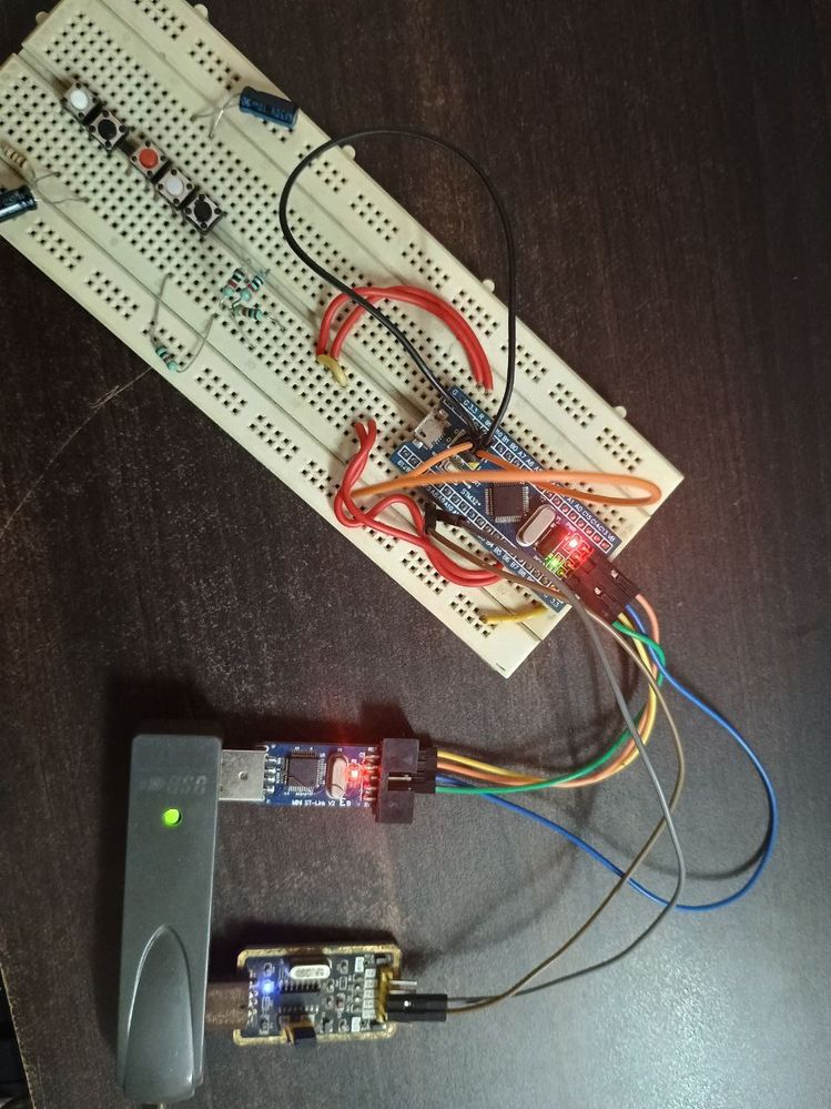

I am using stm32f103c8t6 microcontroller for uploading the bootloader and application. After uploading the bootloader binary code using UART communication (boot1=0 and boot0=1) to the controller, the reset pin is not working for further functionality i.e it is not erasing the current program and the uploaded code is working after pressing the reset button. Please guide me regarding that problem.

I am not using any board. For uploading through ST-LINK i am using a ST-LINK V2 clone.
Your MCU STM32F103RB is soldered on which PCB then? Could you please share a photo of your setup?
Are you using blue pill board?
PS: This is NOT an online support (https://ols.st.com) but a collaborative space. So please be polite in your reply. Otherwise, it will be reported as inappropriate and you will be permanently blacklisted from my help/support.
The above picture is my setup.
Ok,
I had a doubt you are using Blue pill board: https://stm32-base.org/boards/STM32F103C8T6-Blue-Pill.html
and you confirmed it.
At this stage, I can only suggest you (as I mentioned previously) to check reset pin level according to the user button state. If it doesn't present issue, so I suspect you are facing a fake MCU. So I recommend you to purchase a genuine product such as  NUCLEO-F103RB board.
