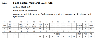

Dear support team,
I need to activate and deactivate the readout protection on a fully automated CI enviroment and according to the RM0440 (Note: If the read protection is set while the debugger is still connected through JTAG/SWD, apply
a POR (power-on reset) instead of a system reset.) a POR cycle is required.
Is there a way to solve this without a POR? The used hardware for CI does not provide means to perform a POR. Is there any G3 register I can manipulate to have the desired result?
Why the behavior is different from STM32F3x? For F3 no POR is required.
Thanks in advance!
BR
Bruno

Maybe by manipulating FLASH_CR register, setting OBL_LAUNCH bit to 1 and wait a bit. Maybe you'll need to re-attach the openocd connection because it will reset the target.
October 31, 2023
Hi, no, this does not work. Only thing that helps is to do a Power On cycle when the debugger cable is attached

Hi, I've added a power on cycle on the process and then it worked.
