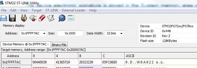

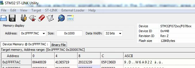

I have made a quick test using ST-Link utility to read the address on STM32F053B-DISCO and it is successful.
-Hannibal-
