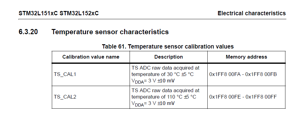

Steps to read the temperature calibration values from the stm32l152rc
waclawek.jan
uint16_t cal1, cal2;
cal1 = *(uint16_t*)TEMPSENSOR_CAL1_ADDR_CMSIS;
cal2 = *(uint16_t*)TEMPSENSOR_CAL2_ADDR_CMSIS;
TEMPSENSOR_CAL1_ADDR_CMSIS and TEMPSENSOR_CAL2_ADDR_CMSIS are defined in the CMSIS-mandated device header.

In the datasheet for your particular STM32 model, look up TS_CAL1 and TS_CAL2 addresses, and then read a halfword from that address.
Maybe related to this thread?
Why is there two addresses corresponding to CAL1 and CAL2Screenshot 2023-10-19 135334.png
waclawek.jan
Each TS_CALx is 16-bit so it occupies two bytes.
Can I get an example souce code to read TS_CAL1 and TS_CAL2 addresses.

One more thing. The Calibration value shows 666 and 849 for 30°C and 110°C respectively. But when I tried to read it using the inbuilt ADC channel the value shows 680 for 25°C. What may be the reason?
waclawek.jan
Different VREF+/VDDA voltage than 3.0V, or some other reason.
